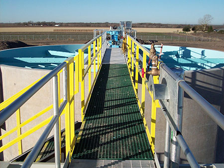

IMAGE 1: FRP offers slip and corrosion resistance, making it well-suited for wastewater use. (Images courtesy of Bedford Reinforced Plastics)
