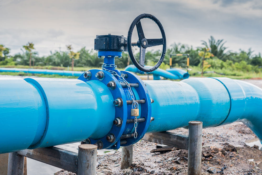

Butterfly valves are quarter-turn flow control devices that utilize a metallic disc that rotates around a fixed stem axis. They are quick-action flow control valves that allow rotations through 90 degrees to move from fully opened to a closed position.
When the disc is perpendicular to the centerline of the pipe, the valve is at a closed position. The valve will be fully open (permit maximum fluid flow) when the disc lies parallel to the centerline of the pipe. The flow control mechanism (disc) has an approximately equal size to the internal diameter of the adjoining pipe.
These valves are available in different sizes and designs that dictate their performance in industrial processing applications; sanitary valve applications; fire protection services; heating, ventilation and air conditioning (HVAC) systems; and slurries. In broad terms, butterfly valves are vital for flow regulation and flow isolation.

Guidelines for the Installation of Butterfly Valves
The installation position of butterfly valves is usually between flanges. Butterfly valves should be installed at least four to six pipe diameters away from discharge nozzles, elbows or branches to minimize the impacts of turbulent flow.
Before installation, clean the pipeline and check the smoothness/flatness of the flanges. Ensure that the pipes align. When installing the valve, keep the disc in a partially open position. It may be necessary to spread the flanges to avoid damages to the seat faces. Use locating holes or a sling around the body when lifting or moving the valve. Avoid lifting the valve at the actuator or its operator.
Align the valve with the adjacent pipe’s insert bolts. Tighten the bolts by hand and then by a torque wrench and slowly tighten the bolts evenly to estimate clearances between them and the flanges. Turn the valve to a fully open position and check the bolts by tightening them using a torque wrench for uniform tensioning.
