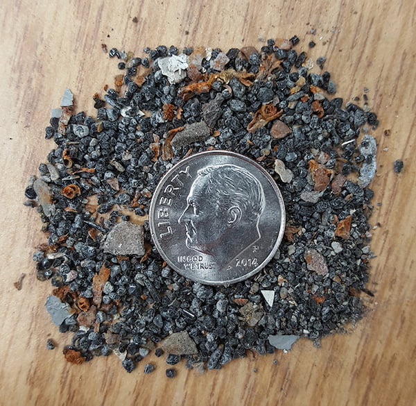

Internal testing was conducted to compare the performance of ePTFE composite diaphragms with two-piece, rubber-backed PTFE diaphragms (see Images 1-5). It involved two identical 1.5-inch inlet/outlet air operated double diaphragm (AODD) pumps at the same elevation and air inlet, media inlet and outlet pressures. One was fitted with an ePTFE composite diaphragm, and the other with a two-piece diaphragm with PTFE facing the media and a thermoplastic elastomer facing the air side.
