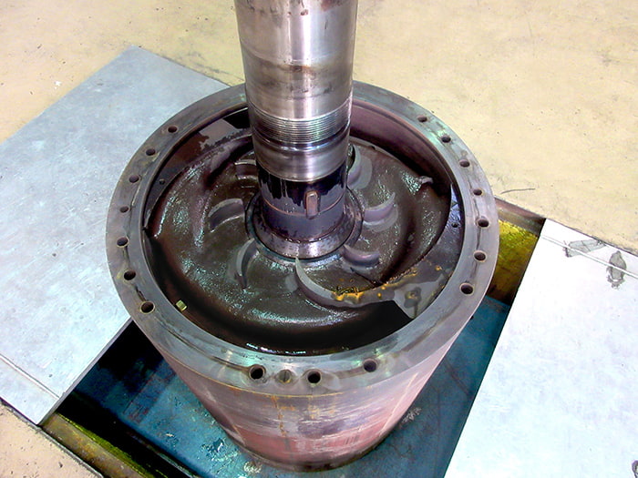

Original Worthington elementImage 2. Original Worthington element being disassembled
Additionally, the bearing housing was removed, and lift was checked on both ends. This is when an imbalance in the pump was discovered. The imbalance caused a rock in the pump, meaning the shaft acted like a seesaw, tilting from side to side. One diffuser added excessive clearance to its stage pieces, moving the stage pieces off center. That caused the shaft, or impeller back hub, to hit that area as it rocked.
