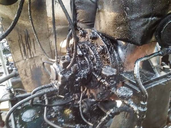

Leaky seal after a few weeksIMAGE 1: Leaky seal after a few weeks (Images courtesy of the author)
But each rule has exceptions, and I am covering one of these exceptions in this column—one that I encountered on a troubleshooting assignment at a refinery that reported continual seal failures every few weeks.
This single-stage double suction pump handled hot (700 F), clean oil (0.8 specific gravity [SG], 3.5 centipoise [cP]), with the best efficiency point (BEP) being 1,400 gallons per minute (gpm), 750 feet head. These were the conditions reported at the beginning of the analysis.
On a first glance, nothing seemed too alarming. So, why was there a problem?
Upon visiting the plant, I gleaned a few more tidbits of information. First, I found that net positive suction head available (NPSHa) was sufficiently higher than required: 20 feet NPSHa versus 12 feet net positive suction head required (NPSHr). This was a good sign. However, when calculating suction specific speed (Nss) for this pump running at 3,000 revolutions per minute (rpm), the Nss value was over 12,000—a warning sign. As we know, too much of a good thing may not be good at all. The question is not how much extra available NPSH you have, but does the pump have the NPSHr too low.

So, the next questions: Are there other “bad actors” in the seal chamber that are killing it? Is it flushed properly? Are there any solids in pumpage?
The pump was originally designed with API Plan 11 seal flush and Plan 62 quench. However, Plan 11 was never implemented, and the seal chamber was dead headed (Plan 2), although quenching (Plan 62) was used. This is unusual, but still was not enough to explain the rate of failures, in my view.
What I learned next was the nature of this pump prewarming after the repairs and startup procedure. While doing a proper prewarming (for nearly two hours) by the externally flushed liquid, the product did  not properly vent. At ambient temperature (prior to startup), the product would be tar-like, with viscosity skyrocketing, as can be estimated from Image 5. More proof of that was the black tar film sitting all over the outside parts of the skid and pipes.
Viscosity vs. temperatureIMAGE 5: Viscosity vs. temperature
It was then possible that cycling cooling and heating (due to product temperature variations), and perhaps aggravated by the starts/stops, might be creating rough, tar-like particulates (as evident from the solidified residue on the pump body), which would further worsen the problem of leak past the seal faces.
During idle time, cooled product would form tar particulates at the seal faces areas, and subsequent starts
(especially with operation at low flow, where seal faces are defected as explained earlier) would drag particles to the seal faces—opened, to begin with—by the radial load at low flow and a cause eventual failure.

Putting together our findings, the following conclusions could be drawn:
  1. The first issue is low flow operation, which causes shaft deflection and opening of the seal faces.
  2. Low temperature (high viscosity) during pump idle time (and perhaps during occasional low temperature operation) would cause solidification of product, which likely remains (at least some of it) inside the seal chamber, setting at the seal faces and causing them to be further jammed open and leak or fail.
  3. The impeller design is not per API recommendations of the low Nss (Nss < 9,500), and the higher value aggravates the problem of suction recirculation and seal issues associated with that.
  4. “No flush plan” (Plan 2) is an additional problem. The seal chamber needs to be flushed with the external clean supply (Plan 32), or at least Plan 11 with the assured way not to clog the flush line.
