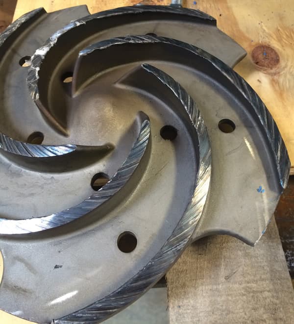

The second most common mistake is operating the pump in reverse rotation—basically, running it backward. This occurs when a pump should operate clockwise (CW) but it operates counterclockwise (CCW) or vice versa. I see this occur at least once per month. For pumps with no way to prevent the impeller from backing off—such as American National Standards Institute (ANSI) pumps with threaded shafts and impellers—this is a major issue.ANSI Pumps
By design, ANSI pumps have no key, nut or pin to prevent the impeller from unscrewing from the shaft when rotated in the wrong direction. Between a nanosecond and a millisecond after the motor is started, the impeller will begin to unthread. It will back off the shaft threads, consequently making the rotating element longer. Then it will drive itself into the casing. The impeller backs off because of the principles of inertia and momentum. With apologies to my hero Isaac Newton for oversimplification of his first law of motion, the basic principle is that a mass at rest tends to stay at rest. The shaft turns, but the impeller will offer some initial resistance or inertia, which starts the unthreading process. In the best case scenario, the driver—usually an electric motor—trips on overload in about one second but not before the impeller is irreparably damaged (see Image 1). When this occurs, the impeller—an expensive and intricate casting that was dynamically balanced to International Organization for Standardization (ISO) G 2.5 standards and specifications—friction welds parts of itself into the casing. The precise curvature and geometry of the vanes that would have yielded hydraulic efficiency are destroyed. The balance will be out of tolerance, and the runout measurements on the vane tips will be totally out of specification. The vane height will also be heavily compromised. At least once because the driver did not trip out, I have seen a pump torn from the foundation, and the schedule 40 steel discharge and suction piping ripped apart..jpg)
