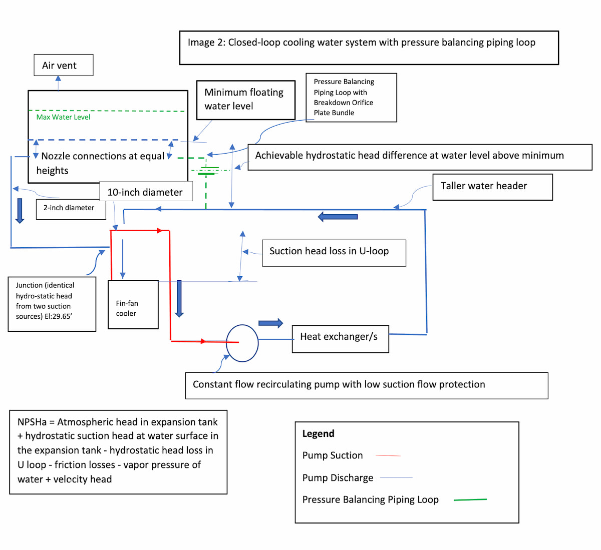

In the case of atmospheric tanks (per UL142), to benefit from an increase in NPSHa, the expansion tank must be located at a higher elevation than the suction (return water) header pipe for the recirculating pump. At pump standstill condition, this may cause the hydrostatic head at the point of merger (junction) between the header pipe from the expansion tank and the pump’s return water header to be greater than the hydrostatic head available from the return water header pipe, causing gravity flow or pump suction flow to occur when the pump kicks in. It is important to recognize that the hydrostatic head at the junction between the two suction sources at standstill condition must be the same to prevent gravity flow occurring when the pump kicks in. The flow pressure at the exit of the header pipe from the expansion tank must not drop too far below the atmospheric pressure (due to a greater area of exposure to return water header), as this would decrease NPSH significantly.
Also, if the hydrostatic head at the junction of the expansion tank is greater than the hydrostatic head of the return water header, the expanded system liquid volume will not easily return to the expansion tank. A pressure balancing piping loop with a breakdown orifice plate bundle connecting the pump’s discharge header pipe with the expansion tank below its minimum water surface would equalize the hydrostatic head at standstill condition at the junction of the two suction sources by availing the hydrostatic head between the water surface at equal height in the expansion tank and the taller discharge header pipe. When the pump “pulls in,” this hydraulic connection will prevent suction flow from the expansion tank, causing full flow to only occur from the return water header connected to pump suction at prevailing absolute hydrostatic head above NPSHr in the header pipe. This identical hydrostatic head at the junction between the two suction sources at standstill condition will also cause the swell of the system liquid volume to rise into the expansion tank when the pump has stopped running.
Having nozzle connections at equal heights below the water’s surface and providing identical orientation (horizontal preferred) in the expansion tank (one each from suction and discharge header pipe) will ensure the hydrostatic head at the junction of both sources is equal regardless of the prevailing water level in the expansion tank above the nozzle connections.
Image 2: Closed-loop cooling water system with pressure balancing piping loop
IMAGE 2: Closed-loop cooling water system with pressure balancing piping loop
The merit of connecting the expansion tank to the return water header via a small diameter header pipe (per UL142) is in its use of the recirculating nature of constant flow closed-loop cooling systems by avoiding the dedicated individual pump’s discharge recirculating water piping loop. However, users will have to accept the extra margin between the NPSHa and NPSHr due to the typical inverted U-suction piping loop, which can be avoided in the case of direct and vertical pump suction piping being used in an ASME-approved tank.
