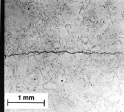

Crack Causes
For many pumps, high mechanical and high thermal stresses can arise in the geometric transition zone. Thermal fatigue is the reason for many crack initiations. Some cracks originate from surface micro-cracks, which can be caused by manufacturing or operational processes. On the shaft surface—especially where the shaft or sleeve contacts the liquid—the maximum stress can be expected because of the maximum thermal gradient and/or the maximum bending effect. Even if a shaft sleeve is used, high stress could still occur on the shaft surface.
The location of the thermal boundary zone in a shaft is critical. If the thermal boundary is located above the crack, the tensile stresses develop in correspondence with the crack and can further its opening. If the thermal boundary is below the crack, the compressive stresses can generate forces that could close the crack.
