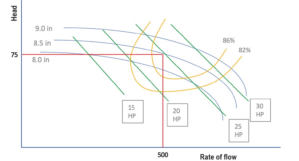

Finding the New Location on the Pump Curve
There are benefits beyond safety and motor protection for these sensors. Image 1 is an example of a pump curve. For the required flow of 500 gallons per minute (gpm) and head of 75 feet, it shows that a best efficiency point (BEP) with corresponding recommended motor hp can be located on the curve. In this example, the BEP would dictate a 25-hp motor.
By leveraging the power sensor data already captured, the pump manager can compare the original hp demand expectations with the measured, or actual, hp requirements. The difference between the original theoretical value and the measured hp value offers insight into process improvement.
