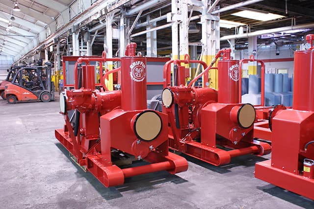

Typical dewatering or contractor pumps deal with water, dirty water or trash-laden effluent, which could come from pumping out a pond, ditch or other source. These are not to be confused with groundwater dewatering, which is a more specific type of pump and system. A dewatering pump can be a small gasoline-driven self-priming pump or electric submersible pump. They can also be more sophisticated dry-priming pumps or larger submersible pumps that will generally only be available from a pump specialty store (Image 2). Stormwater pumps are generally larger. Sometimes they will be of higher pressure than a standard dewatering pump, since they may need to pump the fluid further. Stormwater pumps may be submersible or diesel-driven and will likely need automatic controls for automatic startup. Since they are likely handling large volumes and may have to pump debris along with water, they are nearly always solids-handling pumps.
Image 2. Eight-inch diesel driven dewatering pumps
