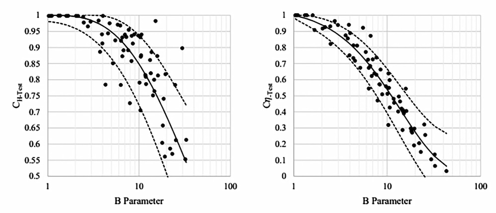

The ANSI/HI 9.6.7-2015 guideline is based on test data for the following pumps and fluids. Thus, the guideline is generally only applicable for systems that fall within these constraints.

IMAGE 1: Test data (points) with 80% prediction intervals (dashed lines) (Images courtesy of Applied  Flow Technology)
Graphing the test data from which the correction factors were based versus the B parameter, research shows that most of the test data points fall within an 80% prediction interval, as shown in Image 1. However, pumps with the same B parameter can have a range of different viscous performance points. Graphing independent experimental data supports the same general trend shown in Image 1.
In most pumping systems the ANSI/HI corrections will provide acceptably accurate predictions for viscous pump performance, especially as engineers include various safety factors and margins of error, as they often do. For situations that call for a more conservative estimation, an engineer can account for the standard deviations on the correction factors. Include the standard deviation by lowering the head correction factor by 0.1 and the efficiency factor by 0.15, which will result in a larger pump and motor.
The viscosity ANSI/HI guidelines are widely used. In fact, feedback indicates that using the corrections does not result in incorrectly sized pumps for most applications. Regardless, engineers designing systems with thicker fluids must understand the uncertainties and limitations of the corrections.
