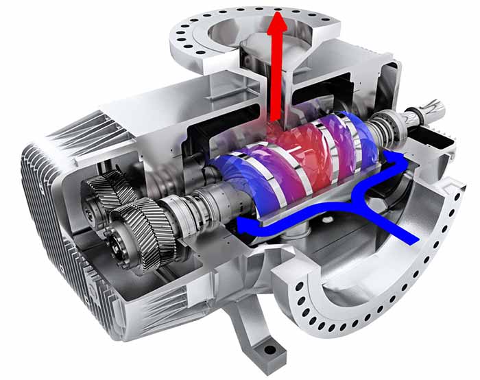

Twin screw multiphase pumpImage 2. Twin screw multiphase pump
Twin screw multiphase pumps are fixed displacement pumps where each pumping chamber forms when the two meshing screws rotate to transport a fixed volume from suction to discharge. As shown in Image 2, the pump has two opposing sets of screw profiles moving the flow from suction at opposite ends of the screws toward discharge. The liquid part of the multiphase flow is necessary to compress gas. As the screws rotate, the centrifugal forces will cause the liquid phase to split from the gas phase and collect at the perimeter of the screw profile, in the annulus of the liner and the screw tips, and in the root of the profile.
As the flow reaches the discharge, the liquid phase is more defined, and a solid liquid slipstream will travel in the opposing direction of the main stream in the annulus formed between by the screws and the liner. This slipstream is a result of the backpressure buildup in downstream flow lines and separators.
