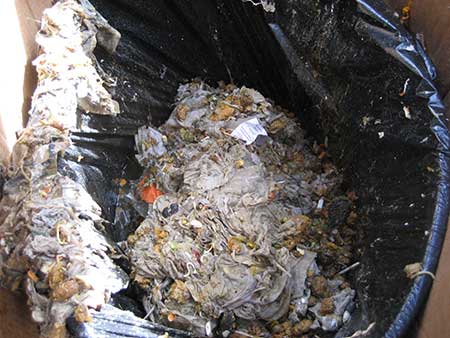

Unbeknownst to most people, the flushing of temporary toilet paper replacements, including wet wipes, paper towels and T-shirts, created unwieldy problems for many wastewater treatment plants across the globe. Even before COVID-19, wet wipes were costing facilities billions of dollars in damage annually, according to the National Association of Clean Water Agencies (NACWA).

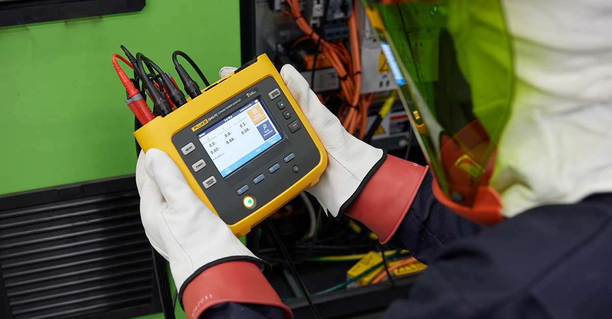

After further troubleshooting, the maintenance team recognized it was not a mechanical problem and began focusing on possible electrical issues. Dietz knew the power monitor’s capabilities and immediately put the tool to use.
“It was the three-phase power monitor that enabled us to see that the pumps, and ultimately the entire station, weren’t grounding properly,” Dietz said. “We isolated it down to harmonics and line voltage fluctuations that were causing varying amperages and VFD anomalies. We were able to diagnose, modify and mitigate the problem by using the power monitor.”

“Thanks to the necessity for remote work, the [power monitor] has been greatly instrumental for us,” Dietz said. “My department got downsized for the pandemic, and since that time, the three-phase power monitor has been used for remote monitoring of our main plant, and specifically our influent bar screen. With the influx of wipes and paper towels being used in place of toilet paper, our influent systems have seen increased load.”
 A bar screen is a critical asset that captures trash before it can enter the system. If the screen experiences a substantial overload of wipes and rags, it can cause motor failure or other issues.
