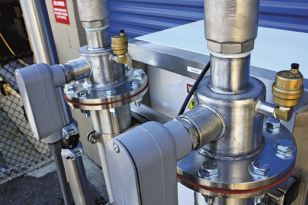

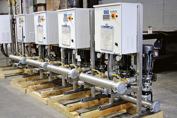

Water Booster Pumps

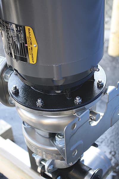

Domestic water booster pumps are among these plumbing devices. Because they are prefabricated, they require certification as an entire system rather than the individual parts. Simply using NSF-certified valves, pumps, fittings, tubing and other parts is not sufficient because the system has not passed the NSF 61 standard in accordance with NSF 372 requirements as required by current plumbing codes.
Despite these requirements, some manufacturers did not begin compliance testing early enough and are scrambling to complete testing. Others put off certification. End users must ensure that the manufacturer of their system is certified to the SDWA amendment, which has been in effect since Jan. 4, 2014.
Users can easily recognize a complete system certification by looking at the certification document provided by the test laboratory. If the certification does not show the complete series of products, the manufacturer may have only certified a component of the system and not the whole packaged system, which means that the system is not fully compliant. Any company that has not completed system testing is in violation of federal law.
A device or system installed in the potable water system that does not pass compliance must be replaced. Any item installed after Jan. 4, 2014, that is not certified must be removed from the system or should not be installed.
