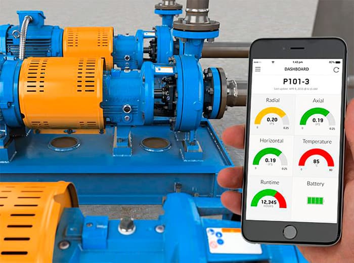

Image 1. Machine health monitor app screen shows the health of the pumps in the background. (Images courtesy of ITT PRO Services)  What Is Smart Pumping?
For decades, the pump industry has been slowly converting from taking a reactive approach to pump and equipment failures to embracing a proactive strategy to dealing with detectable problems. Smart pumping and the IIoT are speeding that transition. Unlike conventional pumping systems that require manual maintenance and checkups on pump performance, smart pumping uses computer technology and sensors to operate, control and protect pumps and their systems. Smart pumping technology offers early detection and real-time diagnostic processes to troubleshoot equipment failures and unusual operating conditions. Common causes of equipment failure include continuous operation below minimum flow; dry-running caused primarily by closed suction valves; insufficient net positive suction head available (NPSHA) causing cavitation; and heat buildup and subsequent liquid vaporization resulting from a closed discharge valve. Smart pumping systems and monitoring technologies can protect against and offer early warning signs for these and other conditions. This modern system tracks any changes in equipment health without manual intervention. By tracking vibration levels, temperature, run-time hours and battery life, these predictive maintenance devices provide real-time updates about equipment health and collect data that plant managers can use for the future. As most industry professionals are aware, excessive vibration can quickly cause wear and decrease pump equipment life. If a breakdown occurs as a result of improper operating conditions, plant managers will have a continuous record of high vibration or temperature levels and will be able to examine why the breakdown occurred. This shift in the industry has significantly reduced pump operating costs and life-cycle costs. Predictive maintenance programs can reduce overall maintenance costs by up to 30 percent and eliminate breakdowns by 70 percent. When most companies manage hundreds and sometimes thousands of machines, effectively collecting and analyzing data can be difficult. This challenge can limit the ability of plant operators to monitor their equipment continuously and in real time, causing a reactive approach to equipment monitoring. Using a proactive approach, on the other hand, significantly reduces downtime, extraneous costs and safety concerns in any pump-operating facility, no matter the amount of equipment. In the past, the number and types of machines that were continuously or periodically monitored were limited. In a smaller organization where people wear multiple hats, the proactive approach of monitoring is ideal because it can quickly be deployed to as many machines as necessary. Self-diagnostic features that detect pump failures give users the time to schedule maintenance and prioritize a problematic piece of equipment before a breakdown or the next visit from a pump specialist.Make the Data Meaningful
As aspects of smart pumping, such as sensor technology, become more advanced and economized, multiple sensors are being incorporated into predictive maintenance devices.
Image 2. Machine health monitor installed on a pump What Does the Future Hold?
