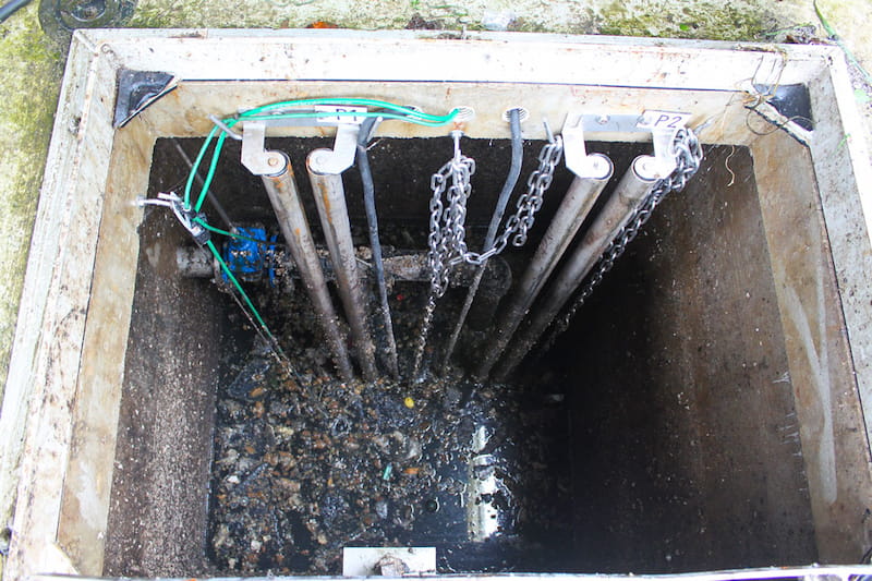

Image 1. Sump before trial (Images courtesy of Xylem Inc.)Integrating Intelligence

Case Study Results
Stony Brook, Suffolk County, New York
Problem: The Suffolk County Department of Public Works Stony Brook Pump Station receives an average 3 million gallons per day (mgd) of incoming flow and was facing ongoing interruptions to pumping operations as a result of “ragging”—buildup of fibrous materials that lead to frequent pump blockages.
Solution: The prototype intelligent pumping system was proposed as a potential solution and it was installed in August 2015.
Results: Before installing the system, it was necessary to lift the pump regularly (once every three months approximately) to remove fibrous materials caught in the impeller. Maintenance cost reduction with the prototype intelligent pumping system was about $1,500 for personnel and $2,500 in equipment costs for the year. The pump clogging was eliminated and the energy consumption was reduced about 20 to 30 percent.
