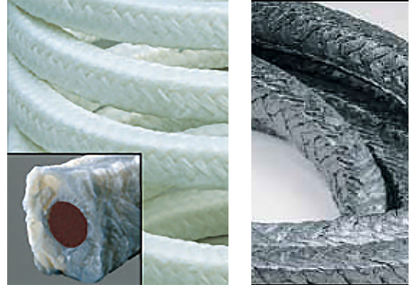

Interbraid rubber core packing and square braid packing
IMAGE 4: Interbraid rubber core packing. IMAGE 5: Square braid packing.
It is important to be able to identify the differences in braided packing construction such as interbraid (lattice) versus square braid packing (Images 4 to 6). It is also important to know why a braided packing is being specified for its features and benefits in an application—maybe it is because of the material, the combination of materials or even the type of construction. Some examples of packing styles that are used in equipment that have specific needs include braided packing with a rubber core (Image 4), used primarily to seal for shaft/sleeve run-out conditions and multi-fiber packing (Image 6) to seal aggressive heavy mediums with graphite-coated PTFE yarn and additional strength of Kevlar
