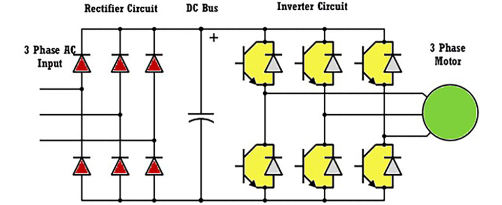

A VFD rectifies the incoming three-phase, alternating current (AC) power to create a direct current (DC) bus. The DC bus uses capacitors to smooth the rectified DC as input to the invertor section. In the invertor section, the controller uses microprocessors to control semiconductor switches that convert the DC voltage to a variable three-phase AC voltage and frequency input to the motor.

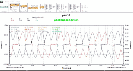

The input voltage to the drive provides valuable information indicating the condition of the incoming voltage supplied to the drive. It calculates any voltage, current unbalance or harmonic content in the incoming voltage or current. The input current indicates the diode’s condition in the rectifier section of the drive. Image 2 shows the current waveform with all diodes firing properly. In Image 3, it can be quickly determined that one or more of the diodes are not firing properly.

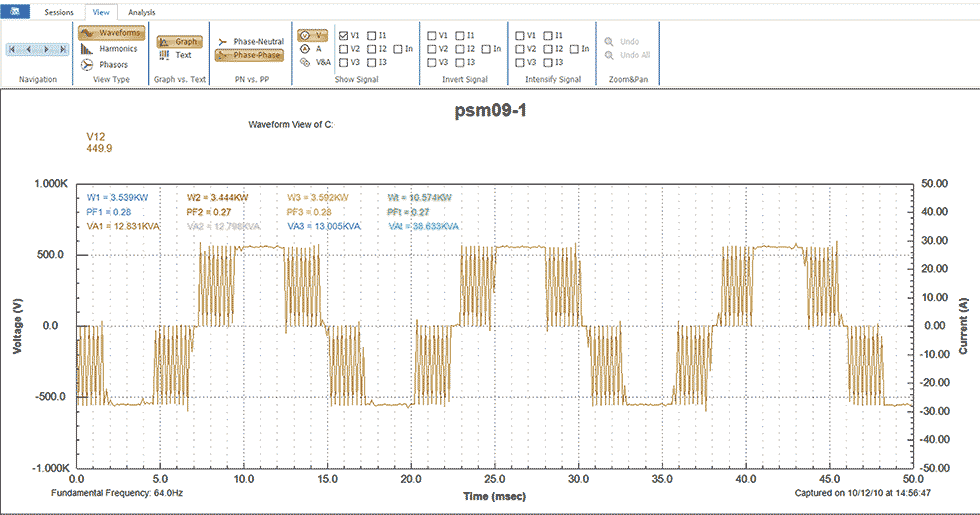

The output voltage from the drive provides information about the condition of the drive itself as well as the quality of the power being provided to the motor. This is including, but not limited to, the proper or improper operation of the semiconductors in the invertor circuits and developing failure of the DC bus capacitors. Image 4 provides a snapshot of one phase of the voltage output of the drive, which is the input voltage to the motor.
All of the output voltage waveforms should be relatively uniform and symmetrical. Nonsymmetrical voltage waveforms indicate failing or failed IGBTs. Ripples on the flat portion of the positive and negative portions of the waveforms iare an indication of failing capacitors on the DC bus. A failed $20 capacitor can destroy an entire drive.

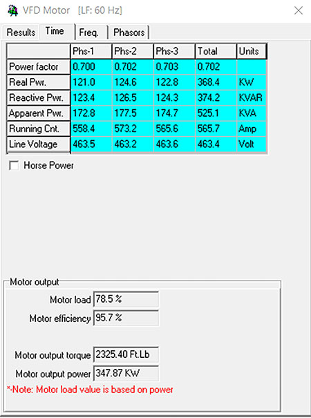

The motor’s current acts as a sensitive transducer for the motor system. Any existing or developing faults in the motor, the driven machine or the process itself will cause the motor’s current to modulate. These modulations in the output current indicate the electrical or mechanical condition or any anomalies in the process itself. An FFT on the digitized voltage and current waveforms identifies faults in the motor such as cracked or broken rotor bars, static or dynamic eccentricity.
IMAGE 5: PQ table on output of VFD
Early indication of developing rolling element bearing failures, balance and the alignment condition of the rotating components of the motor or the driven machine can also be quickly identified using the same fault frequencies long recognized in vibration analysis.

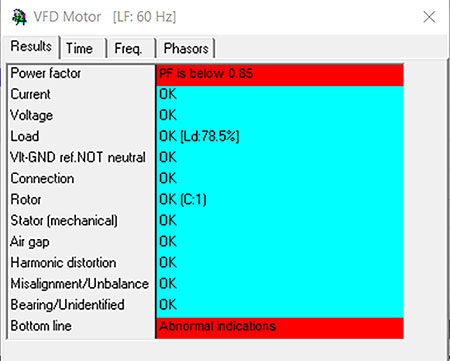

The ESA software combines all the information gathered in the 50-second data acquisition process and compares them to predetermined standards, guidelines and algorithms to create the graphs, tables and displays required to evaluate the condition of the entire motor system from the incoming power to the process. On completion of the evaluation, ESA creates a complete, detailed report that not only highlights developing problems in the electrical portion, developing faults in the driven machine or other equipment connected to the motor but also anomalies in the process that could cause the VFD to trip. The report produced also details measurements that are within predetermined guidelines, thereby eliminating most of the guesswork normally associated with VFD troubleshooting.
