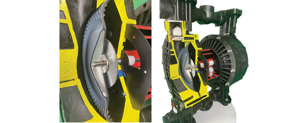

One standout innovation involves the development of novel diaphragm materials. Traditional diaphragms, often composed of rubber or elastomers, can be susceptible to wear and tear, particularly when confronted with abrasive or corrosive fluids. Emerging diaphragm materials, such as polytetrafluoroethylene (PTFE), exhibit greater resilience against wear and tear, thus extending the pump’s life span. The development of one-piece melded diaphragm technology is rising across the industry. This new technology eliminates the pinch points that are typically found in traditional AODs where the outer and inner pistons secure the diaphragm. New melded technology eliminates the center hole and creates a seamless flow cavity, extending the life of the diaphragm up to five times.
