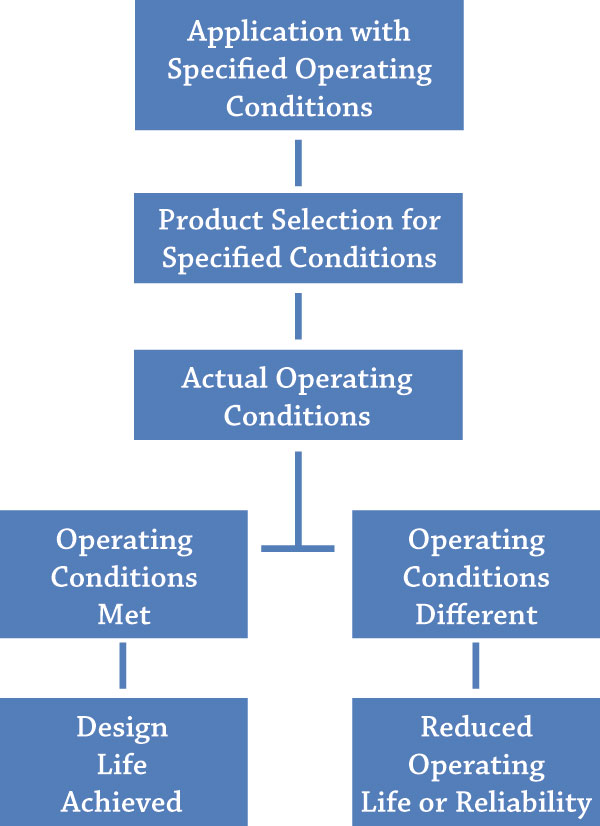

Figure 3.2. The ideal case design life and the factors affecting reliability (Courtesy of Hydraulic Institute)
