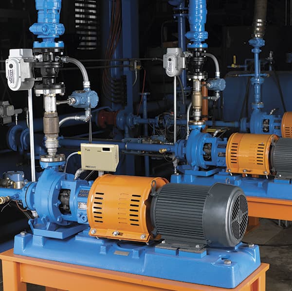

The years leading up to the new millennium saw a rapid evolution of industrial communication networks from analog to digital. By 2000, information technology tools were becoming integrated into fluid handling products and systems. This marked the beginning of pump and automation technology convergence. Process instruments, control valves and stand-alone controllers developed from individual hardware units to microprocessor embedded devices that could be digitally linked into a computer-based process management system. Intelligent pumps also joined the march forward in 2000. Today, “smart” centrifugal pumps with variable frequency drive (VFD) controls are becoming an integral component of the industrial process automation architecture. Hard-wired communication systems in field devices are being replaced by wireless communication as the new standard. What does this communication revolution mean for the traditional pump and automation industry? The migration from hardware to software enables new services that were practically undeliverable in the past. Widespread information flow from process assets helps plant operators make better life-cycle-cost decisions and perform true predictive maintenance in real time, without needing to collect data manually. These changes drive stakeholder innovation and profitability. The old paradigm of business gives way to the life-cycle-costing approach. Organizational structures and stakeholder perceptions are changing. Suppliers are moving from selling commodity products and services to rendering unique, value-added services that are highly customized.
Widespread information flow from process assets helps plant operators make better life-cycle-cost decisions and perform true predictive maintenance in real time. (Article images courtesy of ITT Corporation.)Case Study

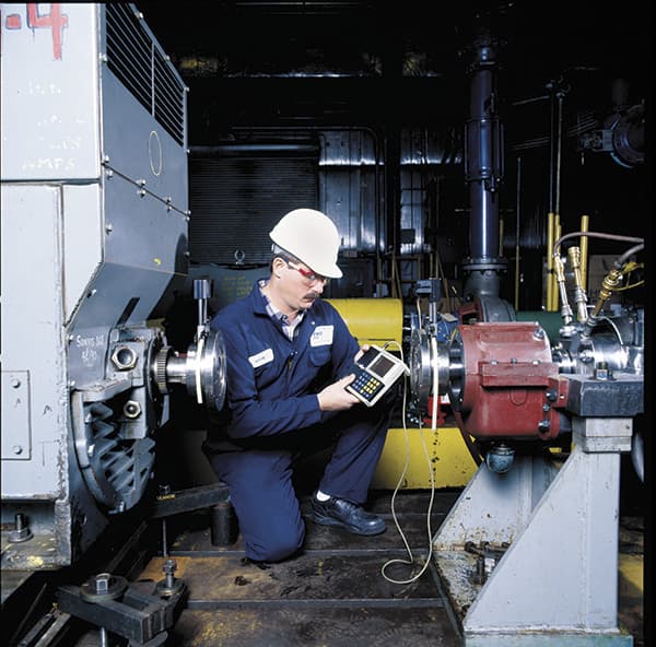

The latest advances in technology offer real-time information on pump performance, helping plant operators make more informed decisions related to their service.
