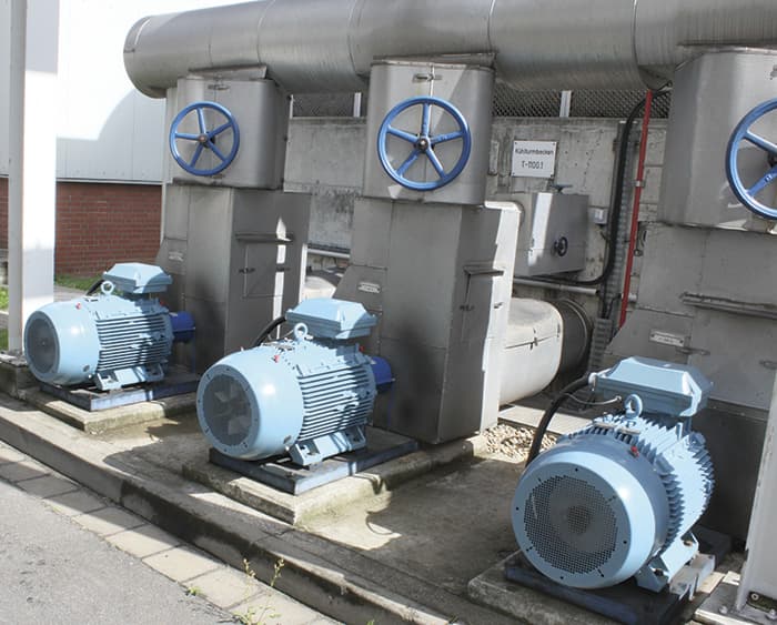

Image 1. The three cooling water pumps with a capacity of 360 cubic meters per hour and maximum delivery head of 52 metersImage 1. The three cooling water pumps with a capacity of 360 cubic meters per hour and maximum delivery head of 52 meters (Images courtesy of Dr. Kurt-Christian Tennstäddt)

Image 2. At the main cooling tower, the fourth pump at the far right is a reserve pump and it is not automatically included in control.Image 2. At the main cooling tower, the fourth pump at the far right is a reserve pump and it is not automatically included in control.
The pump control is central to the new concept. The system utilizes three frequency converters and includes cascade functionality. The 75-kilowatt (kW) IE4+ synchronous reluctance motors achieve an efficiency of 96 percent, an improvement over previous motors (built in 1996) with about 90 to 92 percent efficiency. They even run efficiently under partial load. As a result, procurement costs are amortized in two to three years. Experience in a previous round of optimizations showed that converting control over the cooling tower fans to frequency converters also achieved significant savings.

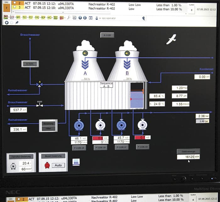

Image 3. The numerous heat exchangers at various locations in the plant are connected to the main cooling tower with lines of different lengths. This places elevated demands on the intelligence of the pump controller. A specific minimum preliminary pressure must be ensured even at the most distant cooler and in every operating state. Pump output and speed  are displayed on the control panel. Image 3. The numerous heat exchangers at various locations in the plant are connected to the main cooling tower with lines of different lengths. This places elevated demands on the intelligence of the pump controller. A specific minimum preliminary pressure must be ensured even at the most distant cooler and in every operating state. Pump output and speed are displayed on the control panel.
