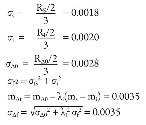

An example calculation is shown below for a 6310, single-row, deep-groove ball bearing. The shaft tolerance used is K5, while the housing is H7. The interference fit is applied only to the inner ring.
Shaft diameter, bore size and radial clearance are the standard bearing measurements. Assuming that 99.7 percent of the parts are within tolerance, the mean value (m∆f) and standard deviation (σ∆f) of the internal clearance after mounting (residual clearance) can be calculated. Measurements are given in millimeters (mm).
Where:
σs = Standard deviation of shaft diameter
σI = Standard deviation of bore diameter
σf = Standard deviation of interference
σ∆0 = Standard deviation of radial clearance (before mounting)
σ∆f = Standard deviation of residual clearance (after mounting)
ms = Mean value of shaft diameter (Ø50+0.008)
mi = Mean value of bore diameter (Ø50-0.006)
m∆0 = Mean value of radial clearance (before mounting) (0.014)
m∆f = Mean value of residual clearance (after mounting)
Rs = Shaft tolerance (0.011)
Ri = Bearing bore tolerance (0.012)
R∆0 = Range in radial clearance (before mounting) (0.017)
λI = Rate of raceway expansion from apparent interference (0.75 from Figure 2)
The average amount of raceway expansion and contraction from apparent interference is calculated using:
λi (mm – mi).
The following equation is used to determine, within 99.7 percent probability, the variation in internal clearance after mounting (R∆f):
R∆f = m∆f ± 3σ∆f = +0.014 to -0.007
In other words, the mean value of residual clearance—(m∆f) is +0.0035—and the range are from -0.007 to 0.014 for a 6310 bearing.
