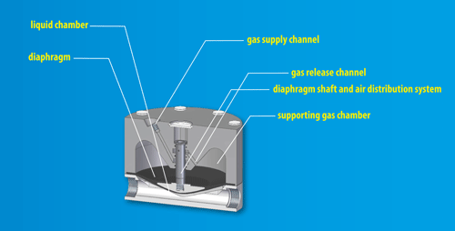

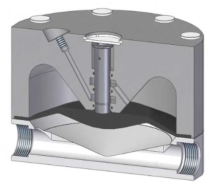

Inline Active Self-Regulating Diaphragm Pulsation Dampeners: Working Principle
Inline active self-regulating diaphragm pulsation dampeners are designed to actively respond to flow and pressure fluctuations. One of the main features is a flexible diaphragm that separates the liquid from a gas chamber, typically filled with air or nitrogen.
The gas chamber is supplied with a continuous flow of gas at a pressure that should be equal to or slightly higher than the highest pressure peak generated by the pump. For example, in the case of a diaphragm pump powered by compressed air, this pressure should match the pump’s supply pressure.
This type of dampener is equipped with an air distribution system integrated with a shaft attached to the diaphragm. This system automatically opens and closes the gas supply, which supports the diaphragm and ensures pressure balance on both sides.
Inside the dampener, two main scenarios occur during the regulating stage:
- When the hydraulic side experiences lower pressure, the supporting gas pressure pushes the diaphragm toward the hydraulic chamber, simultaneously opening the gas outlet to the atmosphere.
- As gas is released, the pressure drops to a level that causes the diaphragm to move in the opposite direction. At its extreme displacement, the gas supply opens again, allowing gas to enter and support the diaphragm.
After several such cycles, the diaphragm reaches a balanced state, where the supporting gas pressure equals the pressure peaks on the hydraulic side. The support gas is consumed by the dampener during the regulating stage.
This self-adjusting mechanism allows the dampener to adapt to constantly changing discharge conditions of positive displacement pumps, which generate pressure based on the resistance within the system. This is particularly important when valves in the discharge pipelines open and close (e.g., during dosing operations) or when the process requires continuous adjustments to the pump’s output.

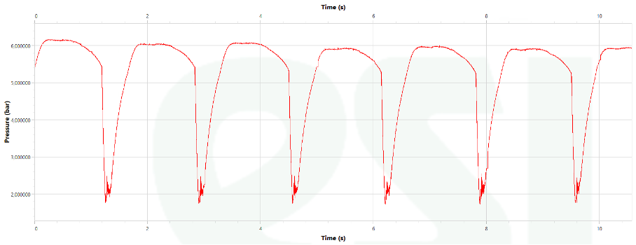

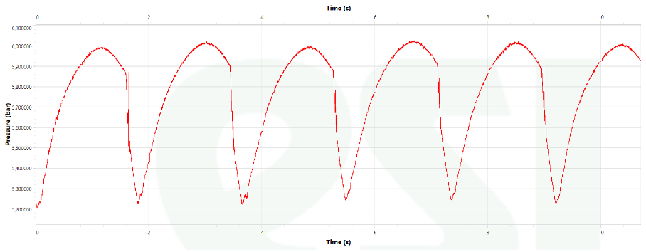

Pressure peaks of a typical diaphragm pump operating at discharge pressure of 6 bar(g):
1) Without dampener; pressure peaks: 4 bar
2) With pulsation dampener; pressure peaks: 0.8 bar
