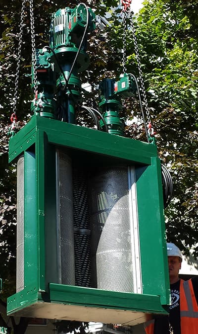

.jpg) Image 1. A grinder is installed to protect lift station for Las Vegas apartment complex. (Courtesy of JWC Environmental)
Image 1. A grinder is installed to protect lift station for Las Vegas apartment complex. (Courtesy of JWC Environmental).jpg) Image 2. A grinder is prepared for installation.
Image 2. A grinder is prepared for installation.Why Retrofit with a Grinder?
Many sewage lift stations in service were not designed to deal with the high-solids content found in today’s sewage. The heavy solids loading, often from disposable wipes, can easily overwhelm traditional pumps, including solids-handling pumps. Typically, when operators find their pumps clogging and failing, wipes-related clogging is the reason. Sewage composition has changed, so the industry standard of the 3-inch spherical solid that pumps were designed to pass no longer meets today’s needs. The addition of a grinder can maximize a pump station’s efficiency while curtailing overtime and unplanned maintenance costs. Grinding wipes and other waste before they reach the pumps is an effective method for preventing damage, eliminating risk, and reduce the time and energy costs associated with clogging. When the wipes are shredded into small enough pieces they do not reweave, rope together or form cumbersome rag balls in the lift stations, they remain in suspension and can be pumped easily. Image 3. A grinder is retrofitted onto the ceiling.
