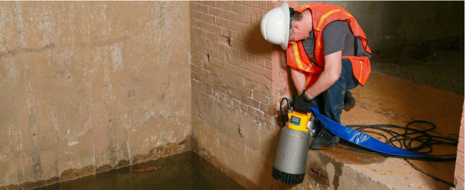

What are common hazards of working in wet well basins?
There are several hazardous area classifications, from stormwater pumping to residential wastewater to wastewater pumping. Venting and the frequency of venting can impact the individual classification. Possible hazards include falls, unexpected movement and issues with crane operation. Ensure there are proper safety hatch grates and rails, and swing check valves to avoid these risks.
