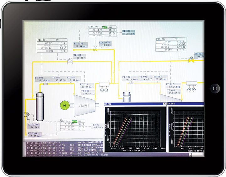

Image 1. A typical process screen (Image and graphic courtesy of IPC)Method Description
Quantitative assessment of compressor performance and health status requires a comparison of measured performance to design, adjusted to actual operative conditions. Starting from OEM design or test performance maps, the software predicts expected compressor performance in the actual inlet conditions (actual suction temperature and pressure and gas mix composition). The software calculates, at the actual running speed, the following expected curves, valid for actual inlet conditions:- discharge pressure vs. suction flow
- discharge temperature vs. suction flow
- compressor efficiency vs. suction flow
- polytropic head vs. suction flow
