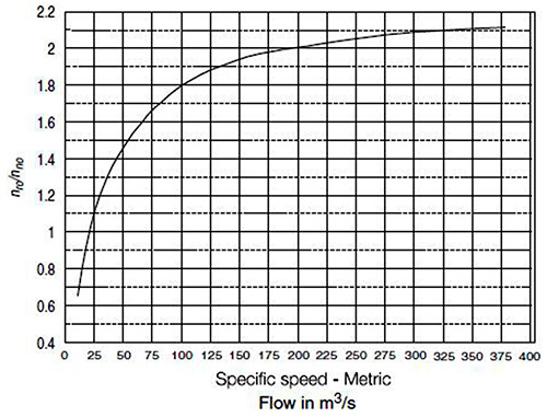

Q. What is a rotodynamic pump’s reverse runaway speed?
A. A sudden power and check valve failure during pump operation against a static head will result in reverse pump rotation. If the pump is driven by a prime mover offering little resistance while running backwards, the reverse speed may approach its maximum consistent with zero torque. This speed is called reverse runaway speed.
If the head, under which such operation may occur, is equal to or greater than that developed by the pump at its best efficiency point during normal operation, then the runaway speed may exceed that corresponding to normal pump operation. This excess speed may impose high mechanical stresses on the rotating parts of the pump and the prime mover.
Therefore, knowledge of this speed is essential to safeguard the equipment from possible damage.
Expressing the runaway speed as a percentage of normal operating speed is practical. The head consistent with the runaway speed in this case is assumed to be equal to that developed by the pump at the best efficiency point.
The ratio of runaway speed (nro) to normal speed (nno) for single and double suction pumps varies with specific speed. This relationship is shown in Figures A.7 and A.8. The data shown should be used as a guide because variations can exist with individual designs.
Transient conditions, during which runaway speed may take place, often result in considerable head variations because of surging in the pressure line.
Because most pump units have relatively little inertia, surging can cause rapid speed fluctuations. The runaway speed may, in such a case, be consistent with the highest head resulting from surging.
Therefore, knowledge of the surging characteristic of the pipeline is essential for determining the runaway speed, and this is particularly important in the case of long lines.
For further review, see ANSI/HI 2.4 Rotodynamic (Vertical) Pumps for Manuals Describing Installation, Operation, and Maintenance.
Figure A.7. Reverse runaway speed ratio versus specific speed (metric)
Figure A.8. Reverse runaway speed ratio versus specific speed (U.S. units)
