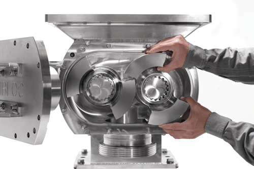

IMAGE 1: Sanitary pumps come with recommended maintenance schedules. (Image courtesy of Unibloc Hygienic Technologies)

A well-made and properly designed sanitary pump used as intended should last for many years with minimal maintenance. Still, as with any machine, sanitary pumps do have wear items and operating parameters that, when compromised, can impact the life span of equipment and ultimately the quality of the product produced in the facility.
Different applications call for different sanitary pump specifications. A supplier will help a user identify a purpose-built pump for the operation. That pump will come with a recommended maintenance schedule, but generally speaking, faster running, lower viscosity, higher pressure applications will need more attention. In addition, food plants that require daily washdowns are particularly hard on pump wear and tear because the extra handling of individual components naturally leads to potential damage that can degrade pump performance and lead to crevices for bacteria to form.
There is no one-size-fits-all approach to sanitary pump maintenance, but this article will address key subject areas for users to keep at the top of their minds. Ensure peak efficiency in any operation by taking a proactive approach using these tips.

Every food processor is aware of the risk of foreign material intrusion. Organic material and random debris can enter the processing line just about anywhere, despite users taking steps to ensure this does not happen. But suppose a user identifies foreign materials upstream of their sanitary pump. In that case, it is important to check the pump head for any damage—such as scratches, galling or dents—that can harbor bacteria or worse, such as introducing metal shavings and additional debris into the product.

Perhaps the most obvious of all indications that a sanitary pump needs maintenance is a change in flow rates or repeated pressure drops. If the product running through a sanitary pump has not changed in type or viscosity, and a user needs to increase rotations per minute (rpm) or pressure to meet the desired flow rate, they may damage the pump head.
A sanitary pump works within its specified tolerances, so deviations unrelated to the product could result from debris, corrosion or abrasion. If nothing else has changed and users are
still experiencing performance irregularities, they should check the pump head for damage.
