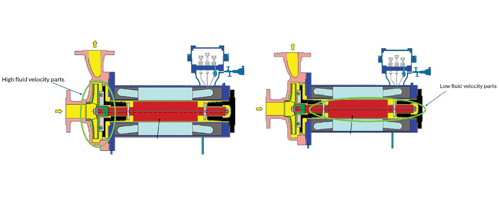

Canned motor pump cross section. High fluid velocity parts circled in green in left image and low fluid velocity parts circled in green in right image

Once these parameters have been established, the end user can hand the baton off to the manufacturer, who must now make some critical material selections. The most intensive selection will be the “wet end” parts. The wet end of a canned motor pump consists of parts that are engulfed in the process fluid. Certain wet end parts will have a higher corrosion rate than others due to the fluid velocity they encounter (such as the impeller, as it is the component imparting rotational energy into the fluid and will see a higher fluid velocity than the bearings and the rotor). The wet end material selection is the most intensive, as it will change based on the process fluid’s corrosivity.

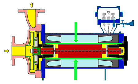

One other critical selection manufacturers must make is the “can.” The can is the primary pressure boundary that contains the process fluid. It needs to be strong enough to retain the fluid at operating pressure while allowing electromagnetic field transmission from the stator into the rotor. The electromagnetic field developed in the stator and transmitting to the rotor is how all induction motors rotate. For these reasons, an extremely robust and corrosion-resistant nickel-chromium-molybdenum alloy (also known as alloy C-276) is often the material of choice for this part. While highly critical, this is not as intensive of a selection since in most cases, the same material is used.
Now that what the end user needs to know about their fluid and why the manufacturer needs this information has been established, it is time to utilize the fluids in Table 1 to outline real-life examples. The first example is water at ambient temperature (75 F) and no solids present. This is a fluid with minimal corrosive properties and allows for many possible wet end materials to be selected. The most common selection in a canned motor pump would be 304 stainless steel, which is a durable yet economic metal. Some manufacturers may even suggest plastics like nitrile or polypropylene. As mentioned previously, the can would be made of alloy C-276, which comes standard in most canned motor pumps regardless of the corrosivity of the fluid.
IMAGE 1: Canned motor pump cross section. High fluid velocity parts circled in green in left image and low fluid velocity parts circled in green in right image. (Images courtesy of Hayward Tyler)

It is difficult to find a standard metal with the necessary anticorrosion properties to fit this application. The manufacturer will likely resort to a specialty material with highly anticorrosive properties like zirconium. In this case, to protect the motor’s materials, a clean water flush circulation plan was opted for to prevent damage to the alloy C-276 can and bearing material. These applications will require more costly materials, but this is necessary to ensure performance and safety with the pump.
IMAGE 2: Canned motor pump cross section, stator can highlighted in green
