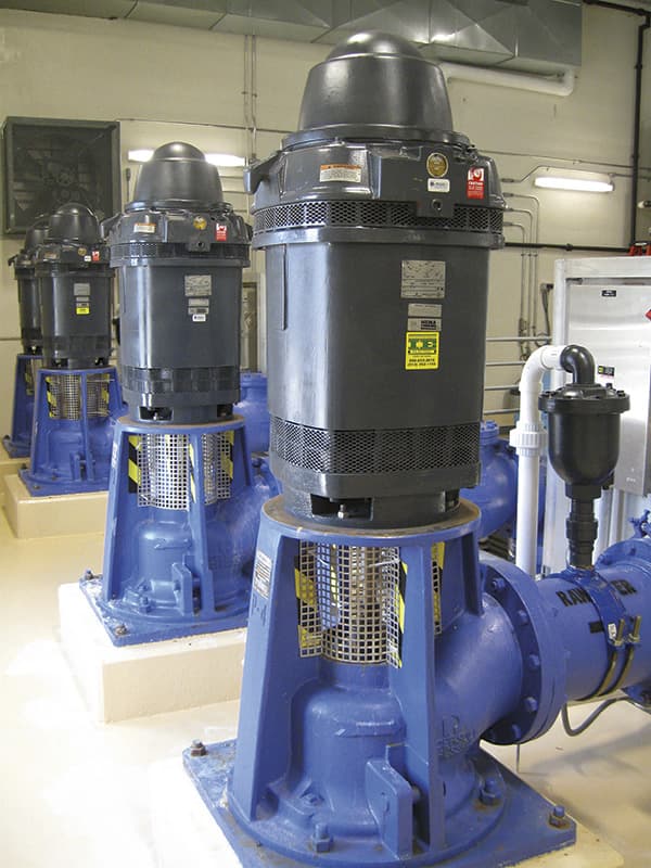

Vertical, hollow-shaft pump motors—such as these at the Reverse Osmosis Water Treatment Center in Hutchinson, Kan.—are designed to minimize vibration. Although the pump is below the motor, the top end provides thrust to the shaft and is, therefore, considered the drive end.Case Study
Dan Biby learned it the hard way. An ordeal involving 13 vertical hollow-shaft pump motors made him a believer in the vertical motor solution. Biby, an electrical engineer with an engineering consulting firm in Wichita, Kan., helped design a new water treatment plant. The plant opened in 2009 but shortly thereafter, Biby found himself in charge of a motor remediation project that would last more than two years. One after the other, the motors—all controlled by VFDs to provide adjustability in flow rate and pressure—developed serious electrical bearing damage. The Kansas City motor repair shop’s proprietary process solved the problems, but only after months of frustration. The motor manufacturer provided minimal help, replacing only the first motor that failed. The first shop Biby tried was unable to make successful repairs on the other motors. Eventually, he found Wilkins’ shop. By the end of 2011, all the plant’s 17 pump motors were refurbished with properly installed shaft grounding devices. To date, they continue to operate without problems. “We’ve learned a lot,” says Biby, who explains that his firm has adjusted its motor specifications so that: All new motors that will use VFDs must be equipped with shaft grounding rings. Shaft grounding devices must be factory-installed or installed by a reputable motor shop with expertise in the proper installation of the devices. If the shaft grounding devices are not factory-installed, a third party shall be engaged to test the installation to ensure that no damaging shaft currents are present. A warranty against VFD-induced bearing damage or failure for the life of the motor is required.More Success Stories
