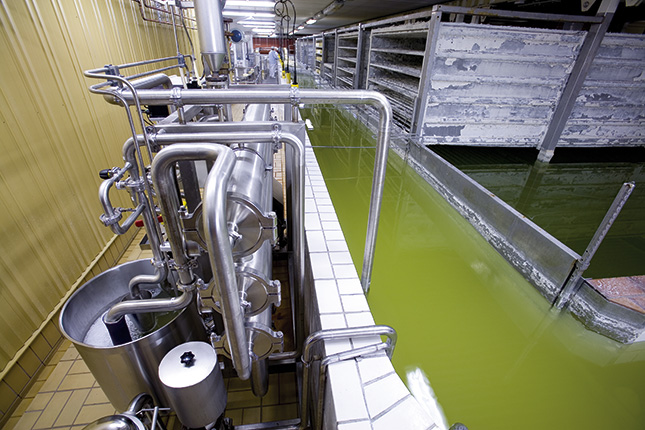

Saline solution used to float cheeses is sanitized by CIP system using a dosing pumpImage 1. Saline solution used to float cheeses is sanitized by CIP system using a dosing pump (Courtesy of Grundfos)

For a dairy company, superior hygiene is essential for maintaining top-quality products and efficient operation. At Milko, the vats used to float cheeses in saline solution require daily cleaning to ensure proper hygiene.
Before the installation of the dosing pumps Milko's CIP system was fully manual, which meant all additives were incorporated by plant employees. To ensure efficient and reliable dosing of additives to the CIP system, the Milko team decided to change the system from fully manual to semi-automatic.
