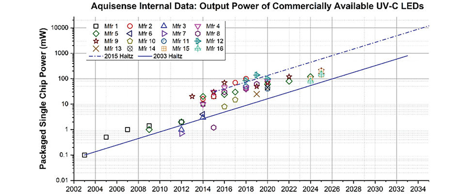

Increased regulatory pressure to eliminate mercury under frameworks such as the RoHS Directive and the Minamata Convention on Mercury is accelerating adoption in larger flow UVC LED systems. The transition is not being driven by regulation alone but also by performance, reliability and system level efficiency requirements for real world POE and industrial deployment. UVC LED development has followed Haitz’s Law, a predictable trajectory where the ability to generate photons increases 20-fold per decade while the cost decreases by a factor of 10.

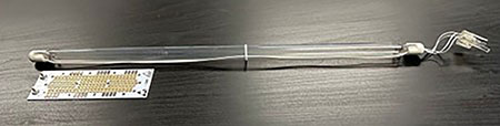

In practice, large capacity UV systems employ multiple light sources in their design, regardless of the platform. Mercury lamps are deployed in banks; LEDs are deployed in arrays. Solid state devices like UVC LEDs scale linearly, predictably and densely.
Commercial UVC LED arrays delivering tens and hundreds of watts or more of optical output are already deployed in water treatment applications. Power density alone often favors LEDs, with arrays achieving higher UV output per unit area than comparable mercury lamps. This allows more compact reactor designs, shorter optical paths and improved integration into skid mounted or space constrained installations.
