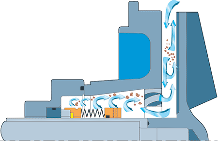

IMAGE 1: Using an engineered seal chamber can be an effective solution for extending the life of seals and pumps while lowering maintenance costs. (Images courtesy of ITT Goulds)

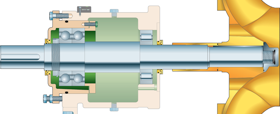

IMAGE 2: Utilizing a precision fit in the sealed and lubricated environment of the power end eliminates adjusting corroded parts leading to leakage.

As pumps handle abrasive fluids, internal clearances naturally increase, reducing performance over time. Designs that incorporate adjustable wear components enable these clearances to be restored without replacing the entire casing. This approach supports sustained efficiency while reducing maintenance time and cost.
In abrasive pulp and paper applications, seal environment management is a critical but often overlooked factor in pump reliability. Fibrous solids, entrained air and vapor can migrate toward the mechanical seal, increasing wear, heat generation and the risk of premature failure. Modern seal chamber and bore designs address these challenges by actively managing internal flow paths rather than relying solely on external flush systems.
Advanced internal bore geometries use hydraulic features to direct solids away from the seal faces while minimizing debris entering the seal chamber. Continuous internal circulation helps remove air and vapor from the bore, stabilizing the seal environment across a wide range of operating conditions and extending seal and pump life. Designs that incorporate renewable, precision-fit wear components further support long-term performance by allowing internal clearances to be restored during routine maintenance without disturbing the casing or piping.
In some applications, seal chamber designs can operate with reduced or eliminated flush water, even at higher stock consistencies. Eliminating flush water lowers operating costs, avoids product dilution and removes common failure points associated with plugging or inadvertent valve closure. When combined with robust seal face materials and controlled internal circulation, these design approaches improve reliability while supporting longer operating cycles in demanding mill environments.
