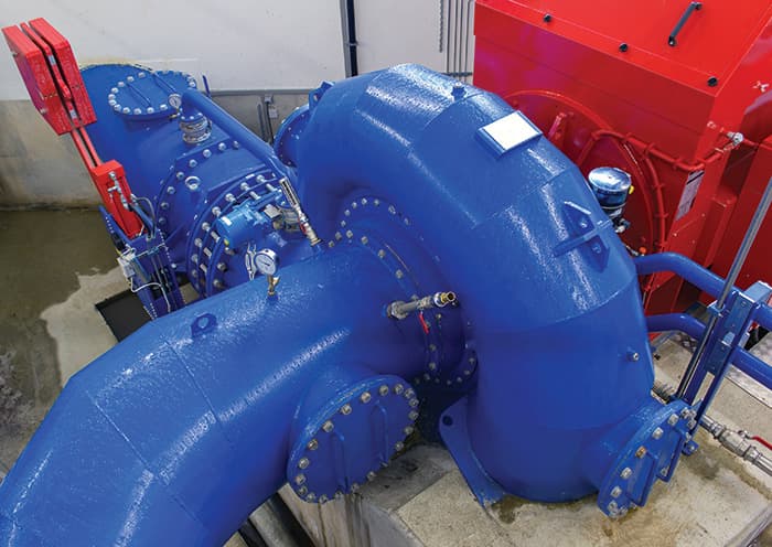

Image 3. Horizontal turbineSafety Monitoring
Safety monitoring for hydropower machines is based on vibration monitoring. Safety monitoring systems use permanently installed equipment that measures the overall vibration values across all measurement points simultaneously. This type of monitoring equipment sounds an alarm or shuts the machine down before a catastrophic failure can occur. Since most hydropower machines have journal bearings, the most effective way to monitor the machine is by measuring the shaft relative vibration by means of two displacement probes per bearing plane. ISO 7919-5 provides recommendations for the type of equipment, what to measure, where to measure and acceptable vibration levels for evaluation. In addition, ISO 10816-5 provides guidelines for measuring and monitoring the bearing housing vibration using seismic transducers, i.e. accelerometers or velocity transducers.
