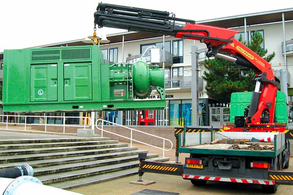

In line with these requirements, the enlisted company produced a prototype pump set that incorporated standard components such as pump, the vacuum system and a diesel engine.
The demands proved challenging. When the prototype was run in the test chamber, the pump performed technically as expected and without problems. But at 5,300 kg (11,685 lbs), the prototype unit was heavier than specified and the noise emitted exceeded the required 70 dB (A). However, using lighter materials such as aluminum and composite helped to reduce the total weight. This made space for sound-insulating materials that could be added to meet noise-emission requirements.
After formal approval of the concept’s suitability, the company manufactured the pumps in 2008, and tested and delivered them to the DCC. A service contract was established that ensured that all pump units were annually serviced to keep them in optimal condition.

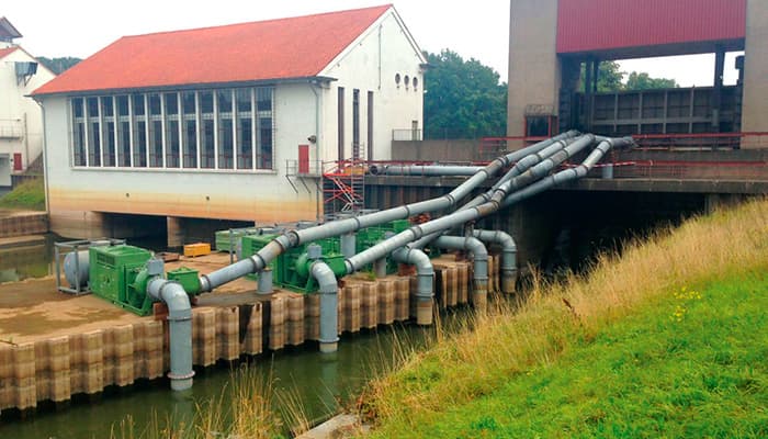

The pumps are used on average once a year in emergency situations nationally and internationally.Pump deployment is not limited to simple placement and operation. Other variables must be taken into consideration, such as the quick verification of the pumping location and the logistical requirements. Should the crisis be overseas, the team must plan for additional factors such as visas, air travel and vaccinations. After consulting with authorities, the team determines the best location for the pump, and the pumping station is quickly built.
In principle, the team is self-sufficient, requiring just fuel and assistance from local authorities. “Every mission is different,” Verbaan said. “Sometimes we receive a lot of help, and other times we have to do much of the work ourselves. But in all cases, we continue to be responsible for the proper preparation and the continuous operation of the pumps. It sometimes happens, when the pumping has to take place over several consecutive weeks, that we also need to train local technical people.”
