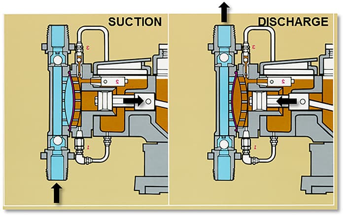

metering pumpFigure 1. Metering pump
How Metering Pumps Work
Chemicals enter a pump’s wetted chamber when the motor drives a piston to create a vacuum that sucks chemicals into the liquid end from external tanks. Alternating piston strokes create pressure that closes the inlet valve, opens the outlet valve and forces the liquids out to the process. Within the liquid end is a diaphragm, which acts as a barrier between the piston and the process fluid (see Figure 1).
The piston’s pumping motion is applied to hydraulic fluid, which causes the diaphragm to flex back and forth as the piston reciprocates. The movement of the piston, which is called deflection, flexes the diaphragm between concave and convex positions. The periphery of the diaphragm is clamped and does not move during the deflection. The greater the deflection of the diaphragm, the higher the flow rate.
For processes that require high flow rates, pump manufacturers have always had to build large diaphragms, with large liquid ends and large housing areas, to deliver the volume and pressure required. As expected, this results in large and heavy pumps. Metering pumps must be able to deliver a wide range of harsh and corrosive chemicals at different concentrations and temperature levels. To accommodate this diversity, all the wetted parts of the pumps’ liquid ends should feature materials that are compatible with those chemicals.
The pump should be equipped with a diaphragm—either metallic or plastic—whose material plays a key role in the equipment cost and weight.
