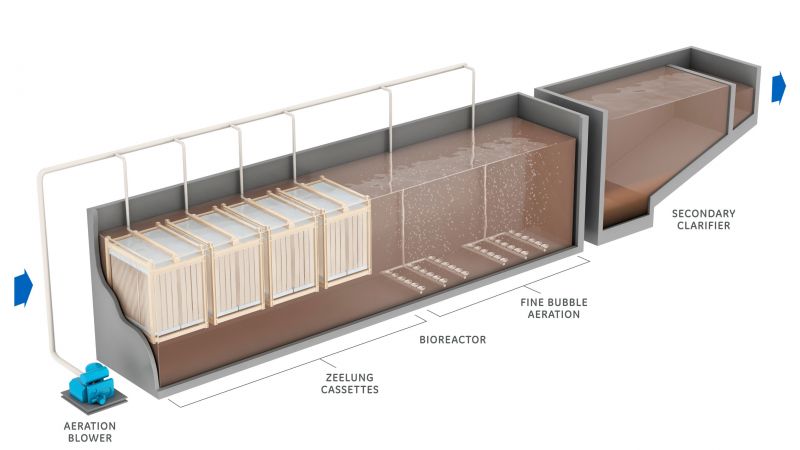

ZeeLung diagramFigure 1. Process flow diagram of how ZeeLung technology fits into an MABR system (Courtesy of GE)
GE’s Water & Process Technologies offers a hybrid system in which 50 percent of the wastewater is treated by ZeeWeed 500D MBR, and the remaining flow of 8 million liters per day is treated by a conventional activated sludge system. Adding ZeeLung MABR to the plant will enable improved total nitrogen removal in the conventional activated sludge stream, GE said.
