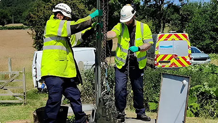

IMAGE 1: Maintenance workers address a pump blockage (Images courtesy of Samotics)

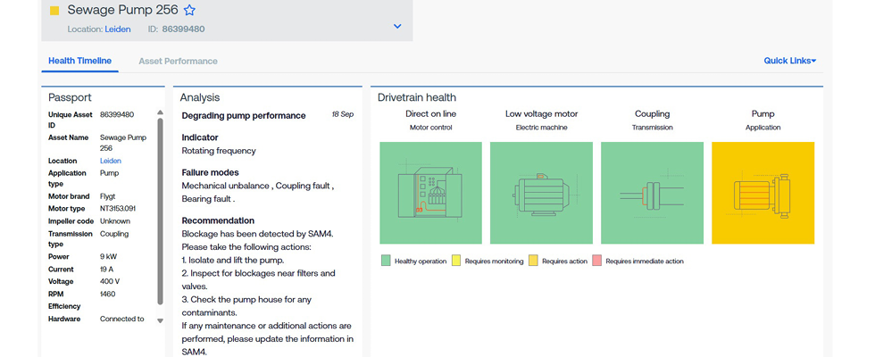

IMAGE 3: An ESA-based monitoring system showing the status of a submerged pump
When ESA-based monitoring was trialed at Southern Water, meanwhile, it detected 63 developing failures on submersible sewage pumps and other key assets across their network. This helped avoid £5 million in potential equipment damage and penalties. Now deployed at a growing number of water utilities, ESA-based monitoring is helping reduce emergency responses, prevent pollution events, eliminate unnecessary pump lifts and build more resilient water networks in the U.K. and beyond.
