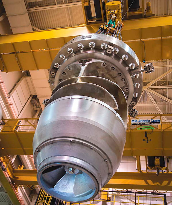

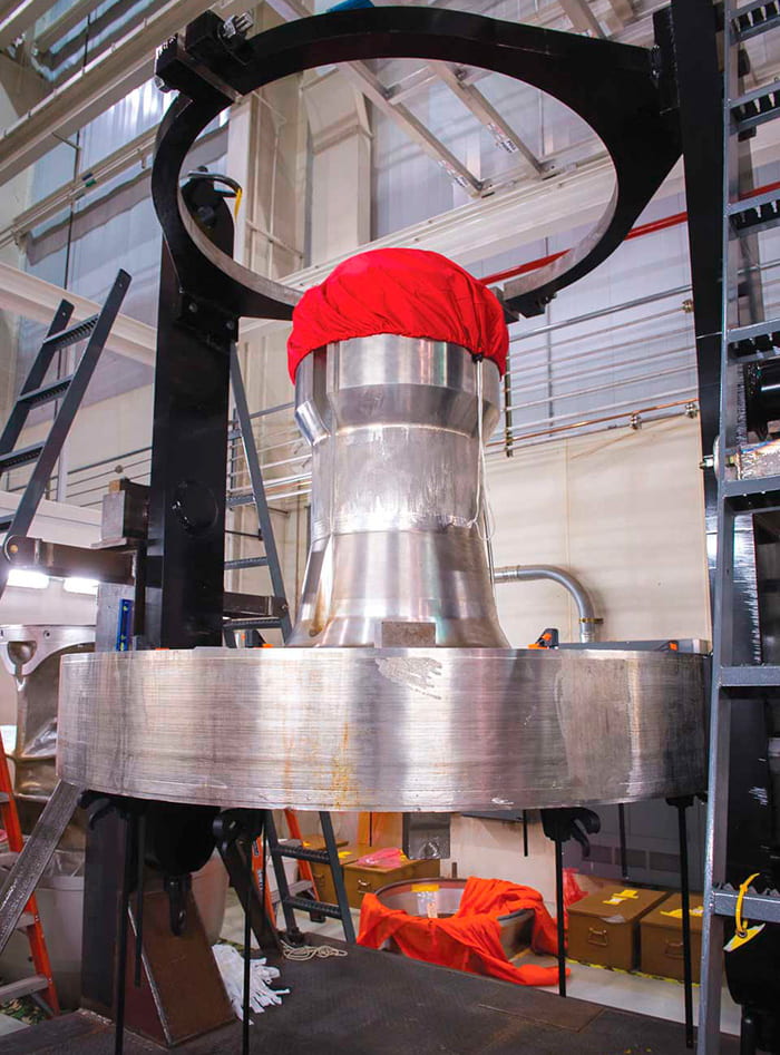

The RCP refurbishment project included replacement of the shafts, impellers, couplings, bearings and all bolting on the pumps. The accelerated delivery schedule required the nuclear energy services company to manufacture these replacement parts in less than six months—a task that normally takes one to two years. Alongside the engineering and manufacturing efforts, the company’s field implementation teams planned the complex logistics of replacing multiple RCPs during a normal maintenance outage. The company’s pump and motor field service team and Surry’s maintenance technicians completed extensive mock-up training exercises, which were integral to the planning and preparation. This also led to the development of new and improved tooling and equipment..jpg)

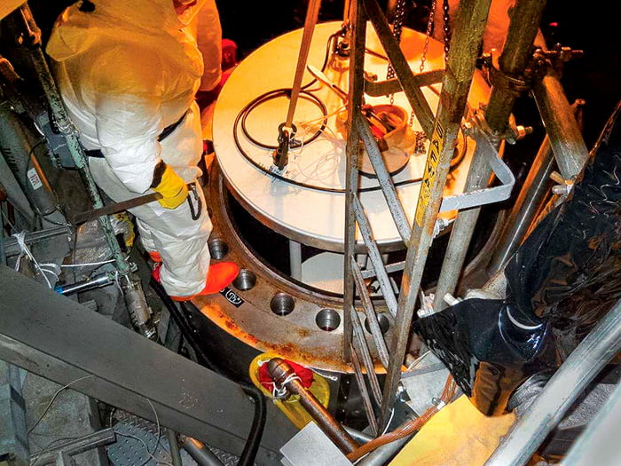

Five RCPs were refurbished and installed without any safety issues, personal contamination events or human performance errors. This performance is attributed to the team’s rigorous focus on safety, which was the No. 1 priority during the entire project. Using full-scale mock-ups for the RCP and machining activities, both management and crew members trained and performed all tasks based on field-like conditions. Ensuring team members experience radiation doses well within regulated limits is a key aspect of every project plan. Practicing critical tasks where expected radiation exposure is higher, such as removing and installing the RCP and the shield plug access cover on the mock-ups, allowed the team to explore best practices to reduce process time and to integrate new techniques that resulted in lowering expected REM dose exposure, also called achieving dose savings. REM is a standard unit of measurement for radiation dosage; it combines the amount of energy produced by the radioactive material with the medical effects of the given type of radiation..jpg)
