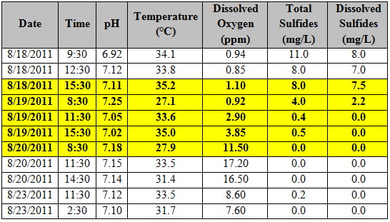

Aside from H2S vapor levels, total and dissolved sulfides and dissolved oxygen (DO) levels (liquid phase) should be examined. For this, only the third-party grab samples were used. Since both data sets were, for the most part, in agreement, this limits any sampling bias and simplifies the analysis. This data set (see Table 1) is complete and precise and supports the Figure 1 data.
During all sampling, the pH remained relatively constant at slightly above 7, averaging 7.11. The temperature was in the range of 27.1 C to 35.2 C, averaging 32.4 C. These are normal values for the location and time of year, indicating that temperature and pH did not significantly affect the reductions achieved and can be eliminated as alternate explanations for the reduced H2S.
What changed was the sulfide and DO concentrations, especially in the range highlighted. On Aug. 19, significant changes occurred, and the data in Table 1 further illustrate the point. The reduction in total and dissolved sulfides between the last sample on Aug. 18 and the first on Aug. 19 was 50 percent and 70 percent, respectively. While these are great reductions, even better was the 100 percent reduction to both that occurred when the first sample was collected on Aug. 20 and continued through the sampling period. A rise in DO was also apparent, increasing from 1.1 ppm to 11.5 ppm. As for the suspected feed line impingement, it was interesting to note the decrease in DO levels that took place on Aug. 23, although the levels were still elevated well beyond what is considered aerobic.
