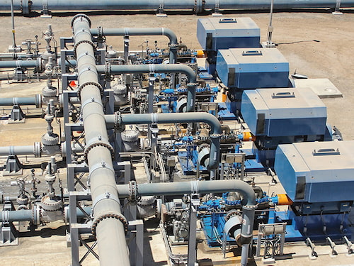

Above: A South American copper mine implemented a condition-based maintenance system to monitor 16 pumps and motors at four remote locations. The system gives mine operators real-time data on all pumps and motors, allowing them to monitor vibration levels, temperatures and more.

Consider a South American copper mine in which four pumping stations transported 16 million gallons of seawater 144 kilometers to its desert location every day.
Pump MTBF was low and mine operators were practicing firefighting maintenance—fixing failed equipment and putting it back into production as quickly as possible. The copper mine implemented both proactive and predictive maintenance strategies.
From a proactive standpoint, adjustments to check valves and control valves were made to slow response times, and pump starting and stopping procedures were implemented that helped mitigate water hammer effects.
The addition of a wireless condition monitoring system allowed maintenance to be predictive with the ability to monitor 16 pumps and motors at four remote locations over a span of 144 kilometers. The results included higher MTBF for the seawater pumping system and a 22 percent increase in annual production.
