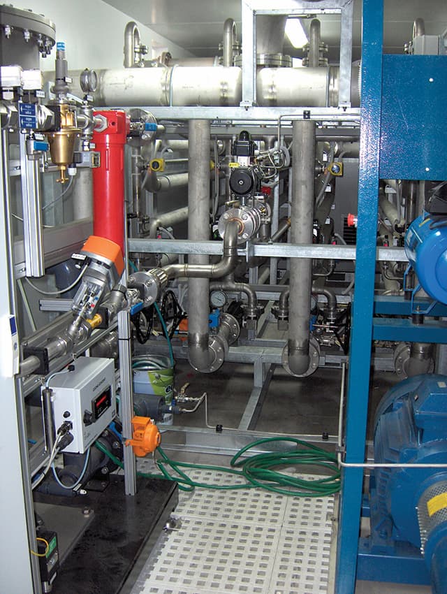

Image 1. Inside view of the sludge container. Pictured on the left is instrumentation in front of the ozone generator. (Courtesy of Xylem)Image 1. Inside view of the sludge container. Pictured on the left is instrumentation in front of the ozone generator. (Courtesy of Xylem)

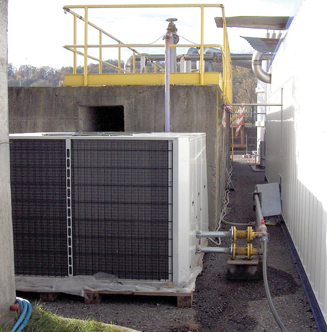

Image 2. Ozone container and chiller with concrete aeration tank and pipe.Image 2. Ozone container and chiller with concrete aeration tank and pipe.

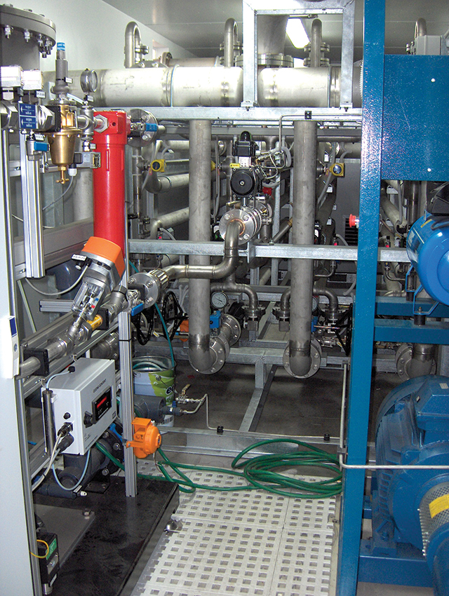

Image 3. Contact system 'Lyso' providing defined reaction time and reaction conditions to ozone treated return sludge (RAS).Image 3. Contact system 'Lyso' providing defined reaction time and reaction conditions to ozone treated return sludge (RAS).

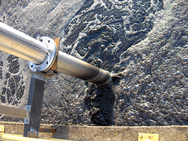

Image 4. The recycling of ozone treated RAS in the aeration tank.Image 4. The recycling of ozone treated RAS in the aeration tank.
