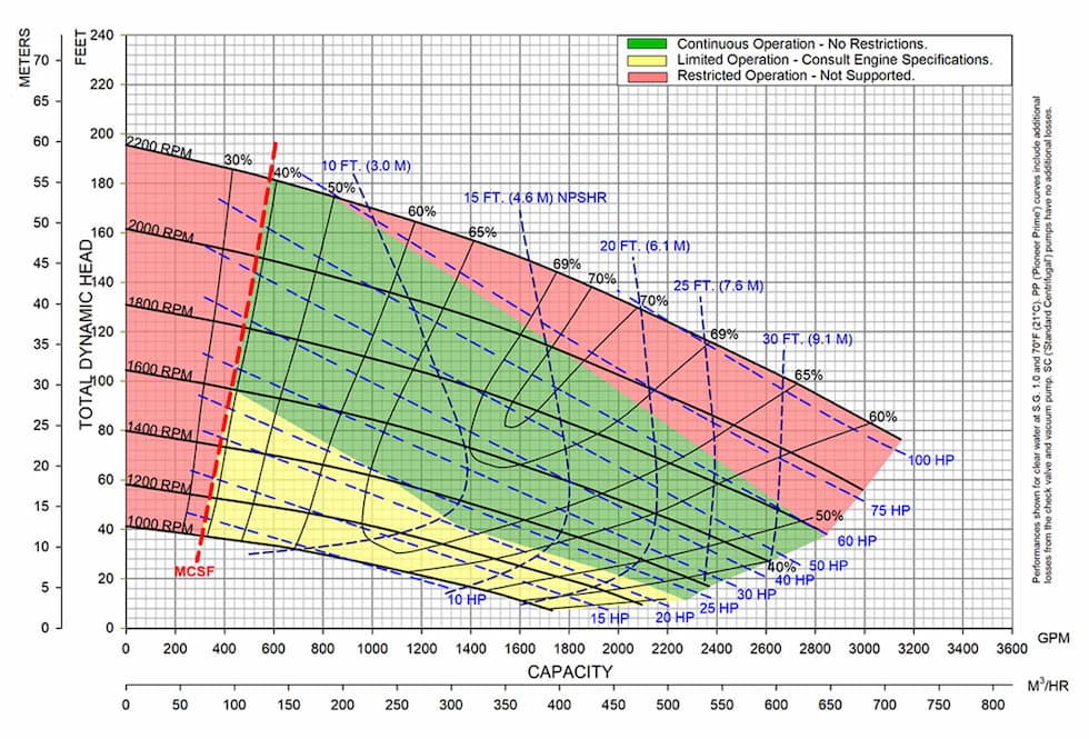

Pump life and longevity can also benefit from these new curves. Running at extreme speeds can cause excessive vibration, which is clearly marked on the package curve as a red or yellow zone of operation.
Package Curve
IMAGE 2: New package curve overlays performance boundaries onto pump curve based on the engine.
The recommended area of operation for the pump package is marked in green on the package curve (Image 2). Following these guidelines will ensure maximum life of the pump.
In terms of efficiency, the benefits go beyond operating and life span: package curves help users invest in the right-sized engine from the start. When following the package curves, users can get a correctly sized engine for the pump, which improves fuel efficiency and DEF consumption rates.
