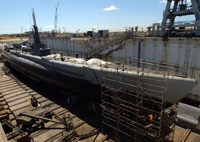

Image 1. The Pearl Harbor Dry Dock allows operators to perform necessary repairs to Navy ships and submarines between service. (Courtesy of PcVue, Inc.)Image 1. The Pearl Harbor Dry Dock allows operators to perform necessary repairs to Navy ships and submarines between service. (Courtesy of PcVue, Inc.)
Three of the four dry docks at Pearl Harbor are in the Controlled Industrial Area (CIA) and are primarily used for repairing and maintaining nuclear submarines. These graving-style dry docks are comprised of a narrow basin with access to deep water through a floating caisson gateway. Dry Dock No. 1 measures 1,001 feet from the head side of the caisson, with a width of 114 feet at the bottom and 138 feet at the top, and a depth of 32 feet 6 inches from the mean high-water mark to the keel blocks.
