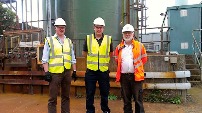

Image 1. Ben Saunders and Wayne Daysh of WES Ltd., a chemical dosing solutions provider, visit the Maple Lodge Sewerage Treatment Works with Thames Water operator Pete Thomas.Image 1. Ben Saunders and Wayne Daysh of WES Ltd., a chemical dosing solutions provider, visit the Maple Lodge Sewerage Treatment Works with Thames Water operator Pete Thomas. (Images courtesy of Blue-White Industries)
