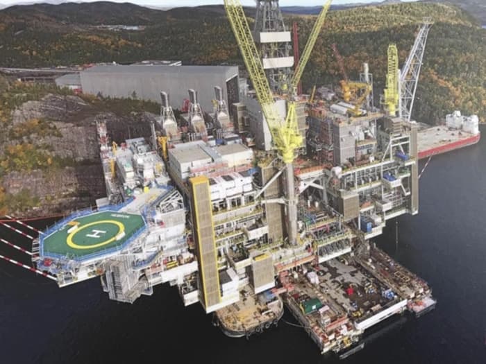

ExxonMobil’s Hebron platform off the coast of Newfoundland and Labrador, Canada, in the North Atlantic is a massive structure. At 230 meters tall, Hebron operates in 93 meters of water and is attached to the ocean floor using a stand-alone concrete gravity-based structure (see Figure 1).
The structure contains more than 40 million cubic feet of concrete—more than what was used in New York’s Empire State Building. It is designed to store some 120 million barrels of crude oil and support 52 well slots.
The platform has the capacity to produce 150,000 barrels per day (bpd) of heavy crude oil, with water volume of 200,000 to 350,000 bpd. It has a water injection capability of 270,000 to 470,000 bpd, with gas-handling capacity of 215,000 to 300,000 standard cubic feet per day (mscf/d). The platform is also capable of treating 190,000 to 280,000 bpd of produced water for disposal overboard and has two offshore loading stations with a total crude-oil-handling capability of 5,400 cubic meters an hour.
