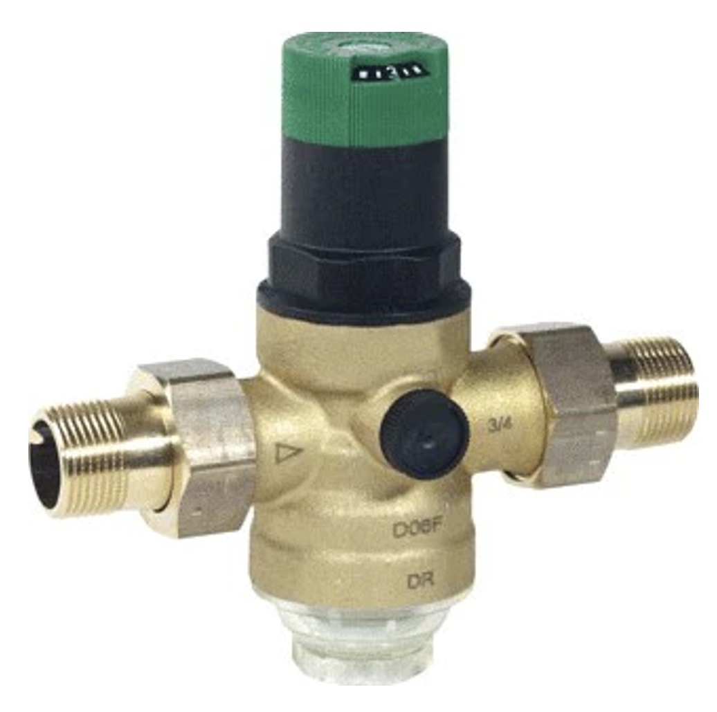

Where Is a Water Pressure Regulator Installed?
To check if a home has a water pressure regulator, locate the point where the main water line enters the building. The regulator is typically installed immediately after the main shut-off valve. If the shut-off valve is not visible at the entry point, inspect areas like the basement, garage or crawl space. A home inspection report may also indicate the location of the valve. Once it is found, examine the pipe just downstream of the shut-off valve.
IMAGE 1: Water pressure regulator (Images courtesy of Tameson)

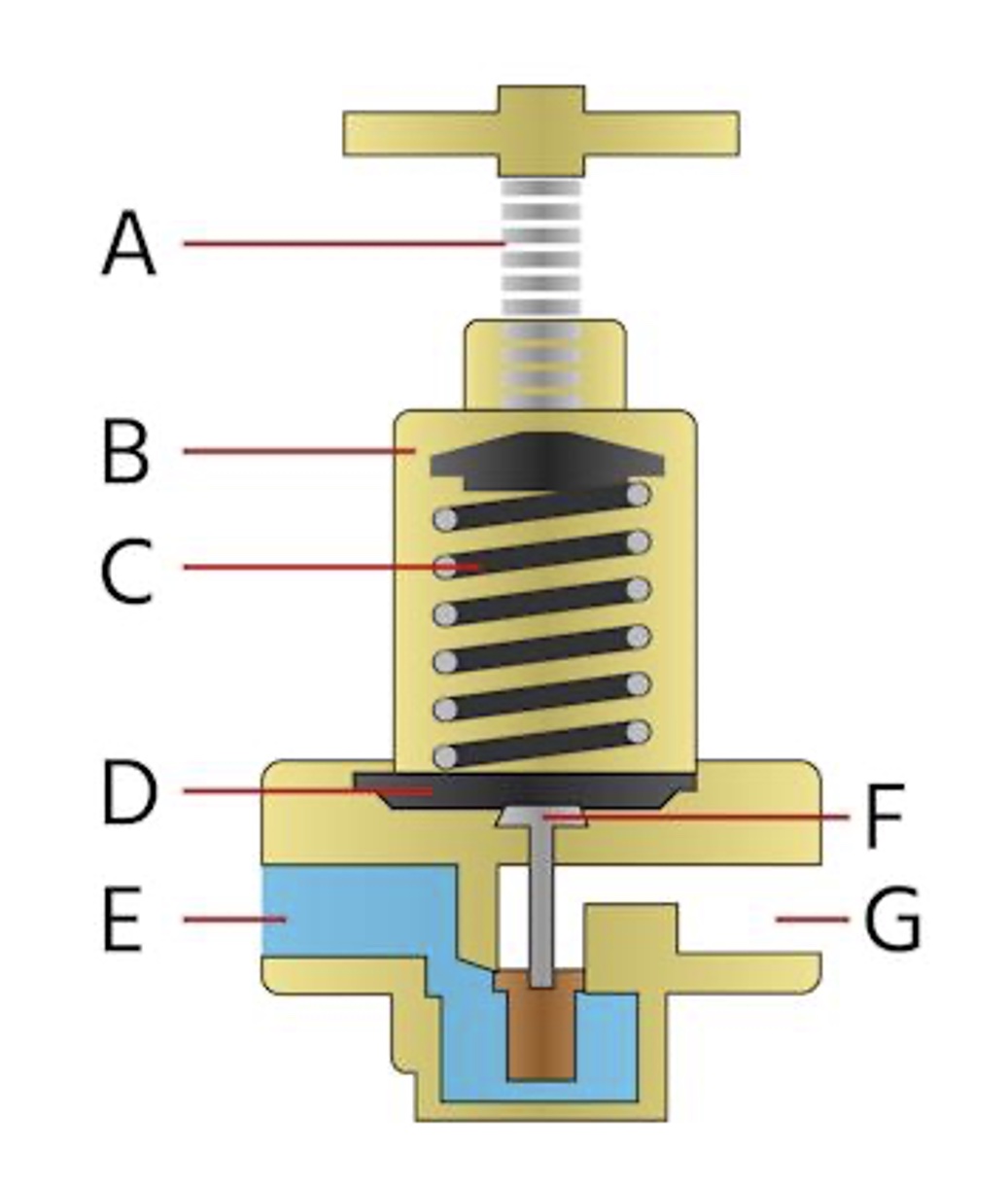

Design & Operation
A typical water pressure regulator design has the following key parts:
  • Adjustment screw: The adjustment screw is used to set the outlet pressure manually. Turning the screw changes how much the internal spring gets compressed.
  • Body: The main housing, typically  made of brass or stainless steel, contains all functional components and is built to withstand corrosion and mechanical stress.
  • Adjusting spring: The spring pushes against the diaphragm. The screw adjusts how much the spring is compressed, which controls the outlet pressure.
  • Diaphragm: The diaphragm is a flexible rubber or elastomer membrane that moves with changes in water pressure.  It balances the force of the spring against the incoming water pressure to regulate flow.
  • Inlet and outlet ports: Water enters the regulator through the inlet port and exits through the outlet.
  • Valve seat: The valve seat opens or closes to control the flow of water. It is located below the diaphragm and, when closed, forms a tight seal to stop the flow completely.
Operating Principle
The operation of a water pressure regulator is based on balancing internal mechanical forces with changes in incoming water pressure. Here is how the regulator works:
  1. Inlet pressure: Water enters the pressure regulator through the inlet port.
  2. Diaphragm and valve action: The water pushes against a flexible diaphragm connected to the valve and creates pressure.
  3. Spring tension: A spring pushes on the diaphragm to balance the water pressure.
  4. Pressure balancing: When the inlet pressure rises, the diaphragm moves down, opening the valve and letting more water through until the pressure stabilizes. When the inlet pressure drops, the spring lifts the diaphragm, closing the valve slightly to keep the pressure steady.
  5. Outlet pressure control: The regulated water exits through the outlet port at a stable pressure, typically set between 2.8 and 4.1 bar (40 to 60 psi) for household use.
Adjusting a Water Pressure Regulator
Many pressure regulators are typically factory set to deliver between 3.1 bar (45 psi) and 3.8 bar (55 psi). In most cases, the pressure can be regulated within a range of 2.7 to 4.8 bar (40 to 70 psi) to suit specific system requirements.
Water pressure regulators have an adjustment knob. Turning the adjustment screw or knob clockwise compresses the internal spring, increasing the pressure. This allows a higher outlet pressure before the regulator restricts flow. Turning it counterclockwise relaxes the spring and lowers the outlet pressure. Check the water pressure using a pressure gauge to confirm the outlet pressure stays within safe, optimal limits. Some pressure regulator models come with a built-in gauge; otherwise, use an external gauge connected to a nearby hose bib or test port.
IMAGE 2: Water pressure regulator design: adjustment screw (A), regulator body (B), spring (C), diaphragm (D), inlet port (E), seat (F) and outlet port (G). The design can vary with manufacturers, and some models have    additional built-in components like filters and pressure gauges.
