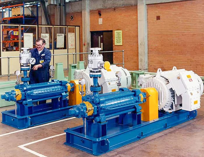

Many different kinds of pumps are used in power plants to fulfill a wide range of applications. Boiler feed pumps are crucial for the operation of power plants. These pumps are typically multistage and deliver feedwater to boilers. An example of a multistage boiler feed pump can be seen in Image 1. Feedwater is then turned into steam, which is what turns the turbines generating power at the power plants.
