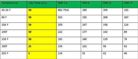

There is a piping material gaining traction in the plumbing and HVAC world. It does not rust, corrode, scale or pit, and it allows pumps to run at their optimum design criteria for the life of the piping system. The material: polypropylene random copolymer for enhanced crystallinity and temperature capability (PP-RCT).
PP-RCT is a corrosion resistant alternative to metallics that can handle more than 100 pounds per square inch gauge (psig) at 180 F, with no degradation in system performance. The life expectancy for various operating conditions can be 50 years with “like new” performance.
This material has been used in these services for decades in Europe, and in the United States for about 15 years. The basic material properties are shown in Image 1.

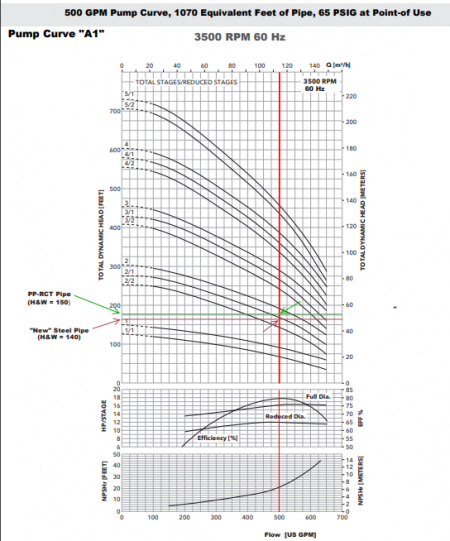

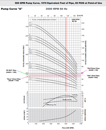

Plot 4 variations of pipe material on a typical pump curve. The variations will include:
- PP-RCT (H-W = 150) with a head loss of 2.4 feet/100 feet
 - new steel (H-W = 140) with a head loss of 1.66 feet/100 feet
 - old steel (H-W = 100) with a head loss of 3.16 feet/100 feet
 - old steel (H-W = 90) with a head loss of 3.88 feet/100 feet
These characteristics result in the following total dynamic head (TDH) for each material:
- PP-RCT: 176 feet
 - new steel: 168 feet
 - old steel (H-W = 100): 184 feet
 - old steel (H-W = 90): 192 feet
All four of these TDHs are plotted on Pump Curve A, along with the vertical line depicting 500 gpm.
Note that 500 gpm plots the pumps at their maximum efficiency.
Upon closer inspection, the data spans two pump sizes.
Here is how this plays out.
On Curve A1, a new steel and PP-RCT is plotted. The new steel plot is below the curve corresponding to a 2-stage (1 reduced stage) pump, so that would be the pump selected for this application.
PP-RCT, however, is above that line, so the next larger pump would be chosen. That would be a 2-stage (two full stages) pump.
Based on the hp/stage portion of the curve, the new steel pump would have:
- 1 full-stage horsepower (hp): 16
 - 1 reduced-stage hp: 12
 - total hp required: 28
For PP-RCT:
- 2 full stages: 32
 - total hp: 32

However, users now have to take into consideration aging—or the change in H-W factor—for old steel due to corrosion. Take a look at Curve A2.
Here, the two old steel plots are isolated. Old steel at an H-W of 100, although above the PP-RCT plot, would still indicate the same pump selection as PP-RCT.
That is, a 2 full-stage hp pump with an hp rating of 32. So here, there would be no difference in initial performance between steel pipe and PP-RCT pipe. Note that the new steel pump will no longer suffice, and the aging of the steel has commanded a larger pump.
But what about old steel at an H-W of 90?
Well, a look at that plot indicates that the next larger size pump would be required. This is a 3-stage pump, with one full stage and two reduced stages.
This would be calculated as:
- 1 full-stage hp: 16
 - 2 reduced-stage hp: (2 x 12) = 24
 - total hp: 40
To accommodate the corrosion of the steel pipe, a larger hp pump must be selected. This is 25 percent larger than the pump required for PP-RCT piping—and almost 43 percent larger than a new steel pump.
The resulting increase in energy costs is:
PP-RCT Energy Savings
- 1 hp = 0.75 kw/hr
 - electricity cost (national average): $0.13/kw/hr
 - savings based on 8-hp reduction: $780/1,000 hours
What if the pump had been selected for new steel? How would aging of steel piping affect the system performance? Look at Curve A3. As the pipe corrodes, the pump’s performance will follow the pump curve, running along the line to the left. Look at how the pump would operate by looking at where the two old steel plots intersect the 2/1 pump curve (new steel pump).
By following those intersections to the efficiency curve, the efficiency would decline to 73 percent as the steel ages.
Note that the PP-RCT piping system will always run at this 80 percent efficiency level, since there is no corrosion, and therefore, no aging of the pipe to consider.
In tandem with this loss of efficiency, the steel system would be providing a reduced flow rate dropping to 460 gpm as internal corrosion takes effect. Again, a PP-RCT system will provide 500 gpm for its operational life without any losses.
